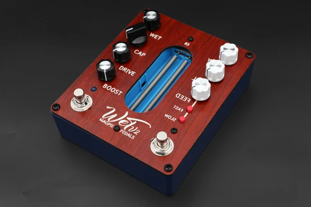

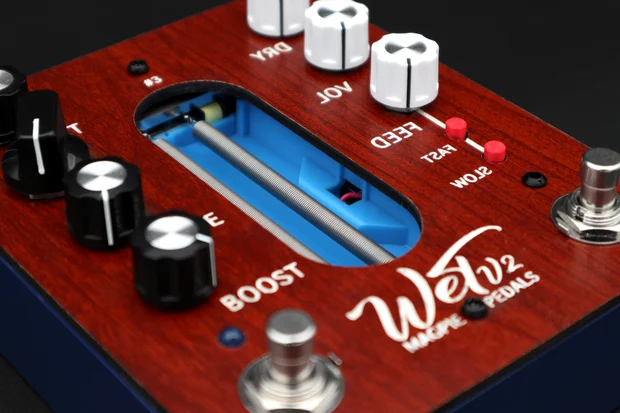

Controls:
WET: Volume knob for the wet signal.
CAP: Rotary switch to change capacitor going into the spring tank. Since larger value = lower tone this can greatly affect how the rest of the circuit behaves and sounds.
DRIVE: In Wet V.2 I utilize a LM386 amplifier to drive the spring tank. This knob sets the amplification of this chip with a gain ranging from 20 to 200.
BOOST: This knob boost the spring tank signal radically. Making it go really screamy and fuzzy. Very fun together with Cap of choice.
DRY: Volume knob for your dry input signal.
VOL: General volume knob for your completed sound of choice.
FEED (plus 2 small buttons and right footswitch): This knob is disengaged when none of the latching push buttons (or the momentary footswitch) are pressed. If anything is pushed down then it tries its hardest to make the pedal not feedback and scream. Please enjoy making it hard for it. The "Fast" button makes it harder than the "slow" button and the footswitch is like a momentary "Fast".
